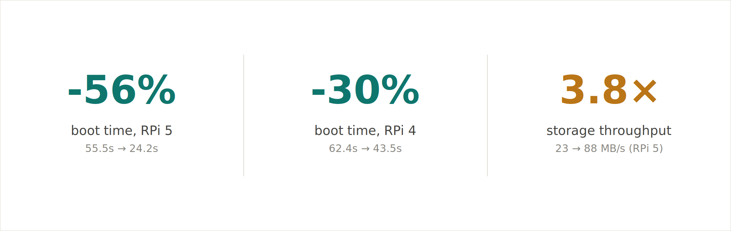

Our Android builds used to take about one minute to reach the home screen on Raspberry Pi 5, which has a quad-core Cortex-A76 at 2.4 GHz. By removing a single kernel parameter from the boot configuration we were able to cut that to 24 seconds, which is a 56% reduction. The Raspberry Pi 4 improved by 30% with the same change.

The Pi 4 negotiated DDR50 at 44 MB/s. The Pi 5 reached SDR104 at 88 MB/s, a 3.8x throughput increase. Here is the full boot timeline, phase by phase:

It is important to note that these numbers are specific to the SD cards we tested. A card limited to SDR25 or DDR50 will negotiate a lower mode and see a proportionally smaller gain, since the improvement is tied to the highest mode the card itself supports.
Why the Raspberry Pi 5 improved more
Both boards used the same class of SD card and were capped by the same flag. Once it was removed, each negotiated the best mode its own controller could reach. The Pi 4's SD host controller tops out at DDR50, around 44 MB/s on this card. The Pi 5's bcm2712 controller completed the full SDR104 handshake at 200 MHz, reaching 88 MB/s. Same card, same flag removed, different ceiling in the silicon.
The evaluation showed that storage throughput improved 3.8x, but total boot time only improved 2.3x. If boot were purely limited by storage, those two numbers would match. They do not, and the gap is itself the useful data point: the phases that are heavy on reads (preload shrank roughly 3x, the PackageManager scan roughly 2x) moved close to the storage improvement, while the phases bound by CPU work and fixed initialization moved less. Boot on the Pi 5 is not storage-bound anymore. The remaining 24 seconds is firmware bring-up, dm-verity hashing, ART runtime initialization, and Android framework cold-start, costs that do not depend on how fast the card is.
